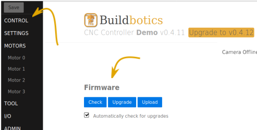

Here's how to install it
Click "Upgrade" on the "Control" page
Enter your password (default is 'buildbotics')
