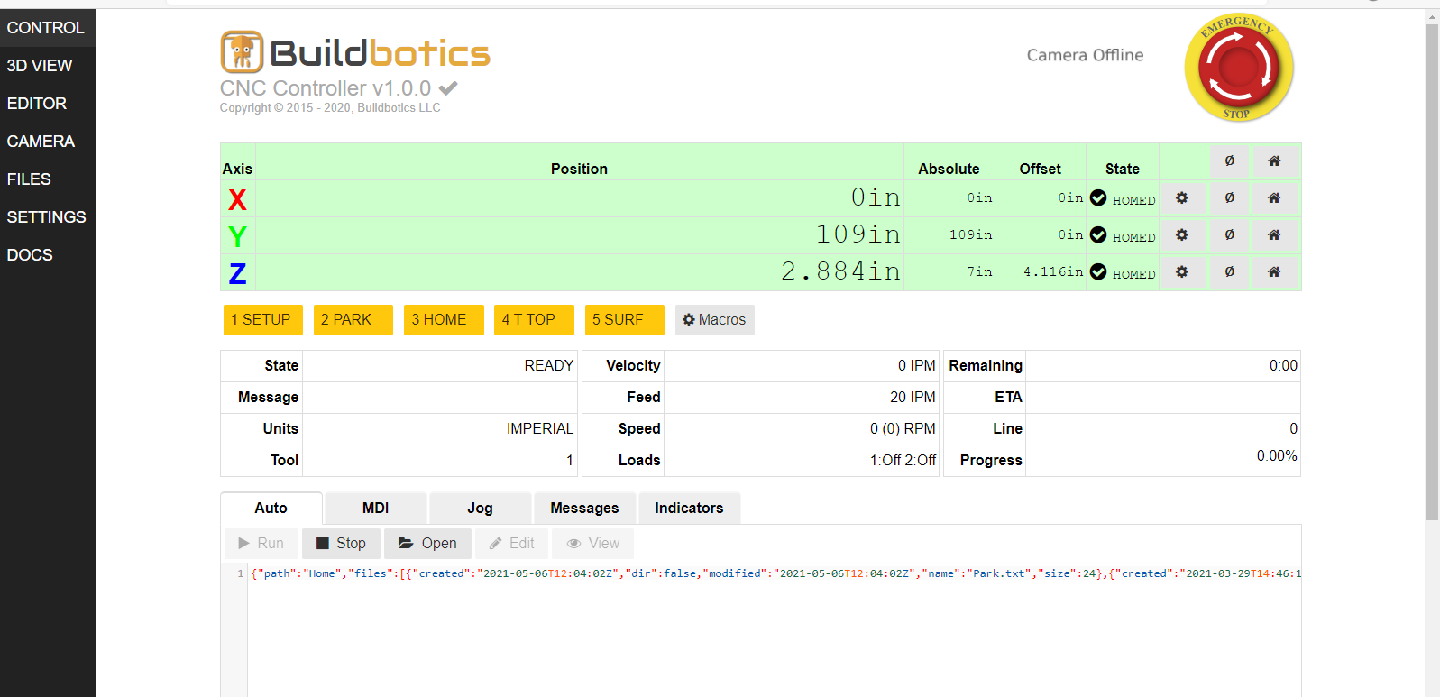

Have got the machine at work updated and dialed in with some new macros buttons. Basic commands like Park, Go To Home, Probe, etc. put this machine right on par with our other routers now making it easier for all operators to use. I can't wait to get home and update the machine there too.
Great job guys!
*Update* Finally made it home and got to play with setting up the buttons on the machine here. Got to tell you I love the onboard g-code editing feature. All I had to do is upload the same macros files from the work mac, open them in editor, change a few numbers and save. What a cool feature.
I haven't been able to run any other files yet but the buttons have me very happy. Again great work guys!! Thank you.
