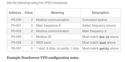

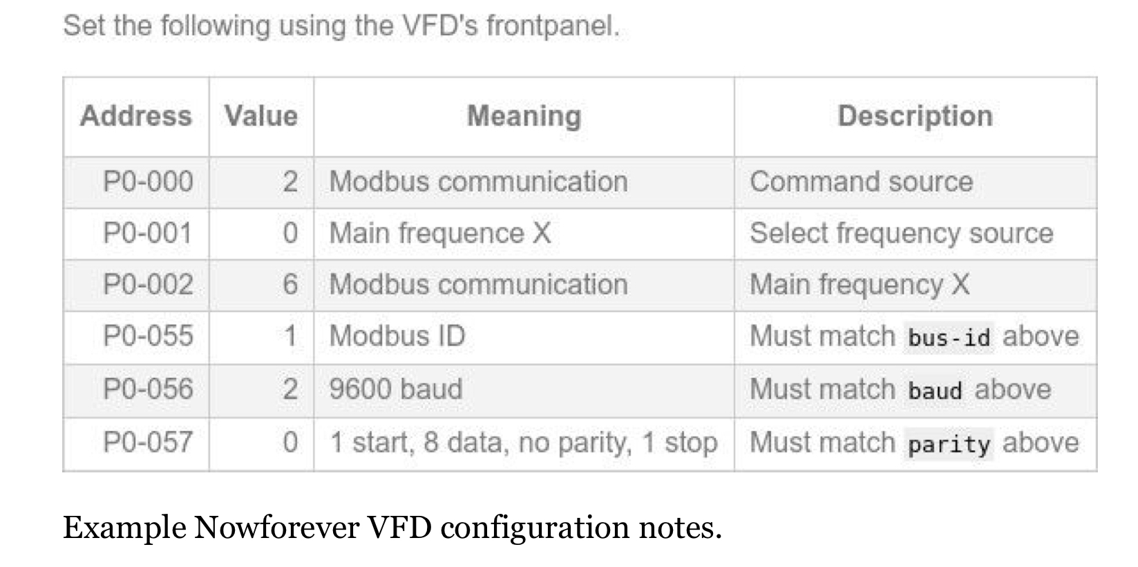

Is it possible to provide, according to the Version 1.0.3, Tools Configuration for the Fuling VFD, what parameters I should change (set) on the VFD. I have these example from the Controller Manual for the Nowforever VFD, as the picture below, and just need the same kind of information for the Fuling DZ3B00 VFD.
