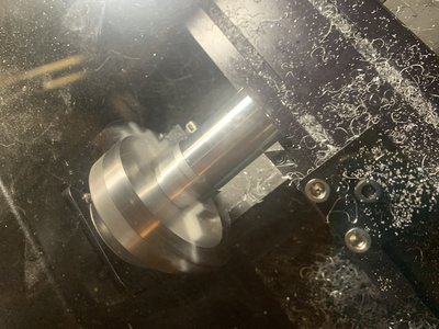

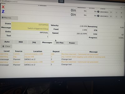

Finally back on testing the lathe and ran into a small problem. I have ran the program several times so far just cutting air over the last week and have had no problems. I put a piece of aluminum in and run the same program with no changes and about half way through the machine goes into Estop and has the message “machine alarmed- command not processed”. I again ran it just cutting air and again ran with no problems. So I set the part back up and tried again to only get the same error. Any reason anyone can think of why this is happening?

No its only half way or so down the part when it does it. Runs fine when there is no part in it. It won’t let me add the video of running and stopping but I added a photo of the alarms and a photo of the cut it did make.
