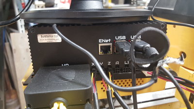

Post by Shindog » Mon Sep 21, 2020 9:45 am
Back of my controller.
Guess I was too early to the party?
Back of my BB controller
Re: DynaMyte 2400 retrofit HowTo Video
Post by Doug » Mon Sep 21, 2020 4:11 pm
Yes, we weren't bringing out the monitor port to the back of the controller for the first few months. The port is available on the Raspberry PI and if you managed to get a hole through the back of the controller, you could plug directly into the RPI.

Shindog
Posts: 7
Joined: Tue Feb 20, 2018 12:49 pm
Post by Shindog » Tue Sep 22, 2020 6:56 am
Yeah, I went ahead and open it up & got monitor connected inside. Only spent a few minutes on it, but when I turned everything on, I only saw the boot up sequence (lots of text scrolling) rather than the BB logo. It ended with a login prompt. Do I need to set something to get the interface to present on the monitor?
Post by Doug » Tue Sep 22, 2020 7:49 pm
You probably need to upgrade the software.
Post by Shindog » Wed Sep 23, 2020 8:41 am
Hmm... It's running v0.4.14 - with a checkmark next to it on the web interface: this indicates "latest version" -- correct? Or were you referring to something else?
