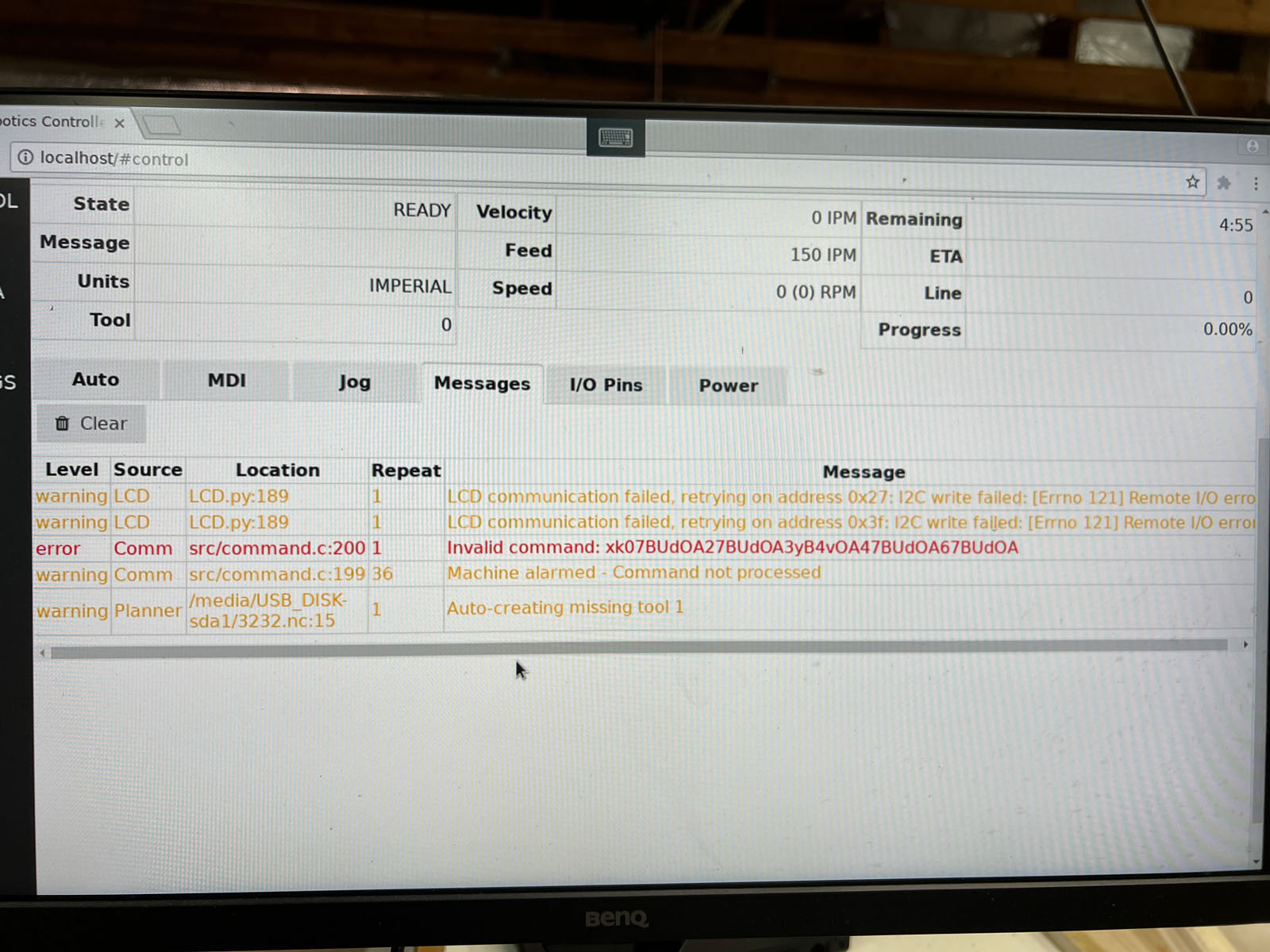

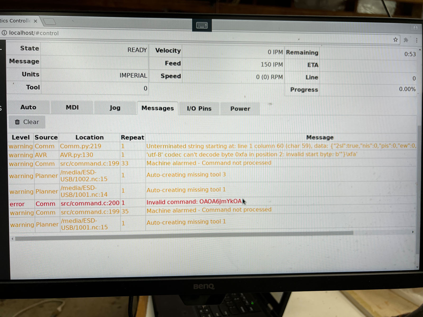

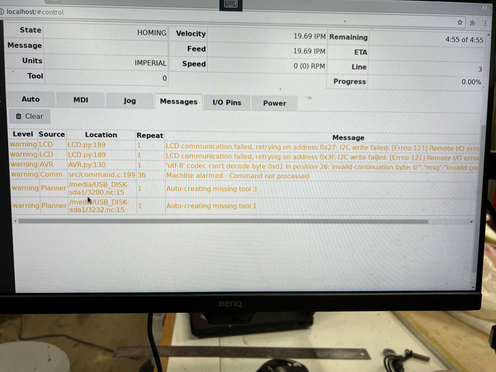

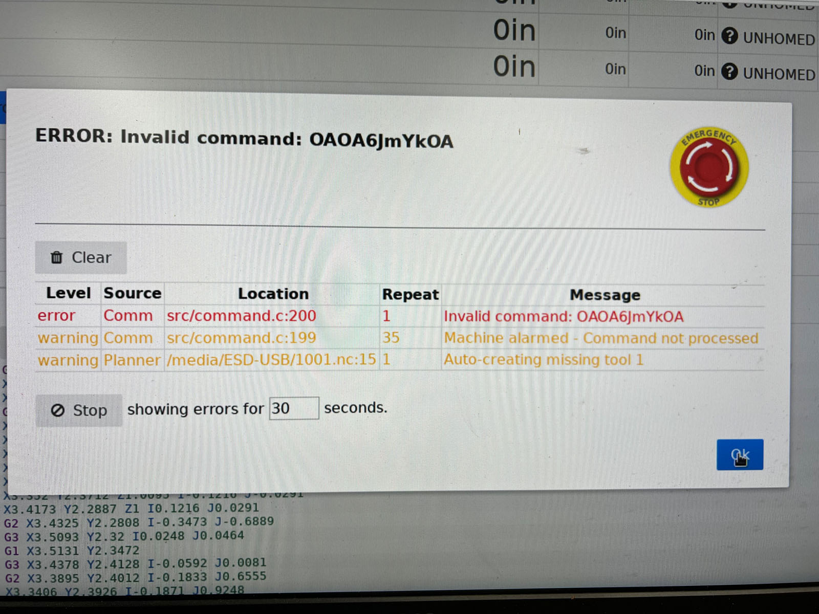

I keep getting recurring errors that occur in the middle of cuts. I lose home and offset positions each time it happens.
I never had any of these errors before the last firmware update but now it is very common. I'm using the Fusion 360 post but I don't think it is related to gcode.
How can I diagnose and fix this? Is there a way to reset the controller?
I have attached images of the errors I'm getting.
Thanks

What version of software are you running?

I'm using v1.0.3

I have beta software that may help. It has not been fully tested so it might introduce other problems. Would you like to try it out?

Here is a link to the file:
https://buildbotics.com/bbctrl/bbctrl-1 ... 12.tar.bz2
Download it to your local computer. Do not decompress it. Then use the 'Upload' button from the Settings->Admin page to load the local file.
If you need help doing this, give me a call at 707-559-8539.
Let me know if this helps.
