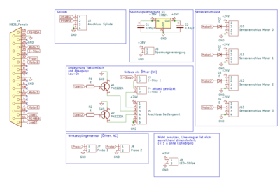

We do use a couple sensors and relays via a custom breakout board thats connected to the 25-pin connector, but I am not certain if and how they are supplied by 5V, thats not my expertise.
List of whats connected:
- fixed tool length sensor (Sorotec WLS2)
- inductive limit switches for all axis (10...30 V 2 mm NPN NC)
- external relays for vacuum table and dust collection (Load 1 and 2)
- 2 e-stops in series
I attached the diagram for our custom breakoutboard, unfortunately its in german

I don't see anything any problems in your schematic.
