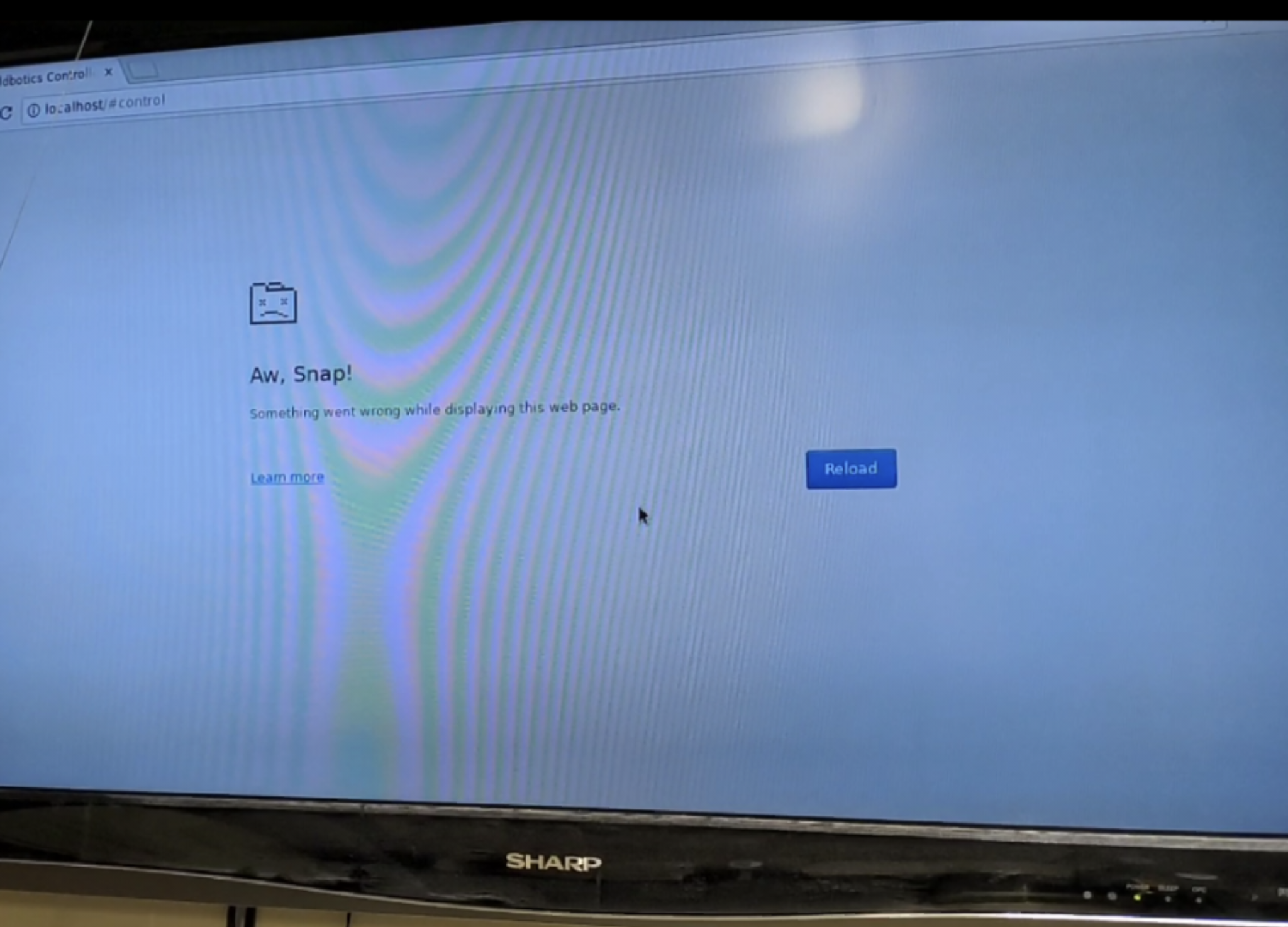

Post by Doug » Sat Jan 02, 2021 5:50 pm
I have never seen the controller in this state. Can you post a picture of the screen when it happens?
JPG963
Posts: 9
Joined: Tue Nov 03, 2020 2:47 pm
Re: Browser/display timeout on longer carves
Post by JPG963 » Sat Jan 02, 2021 8:39 pm
Here is what is displayed through the hdmi output. When this occurs webcam can not be viewed remotely until refresh is clicked. Does not effect running gcode
Post by JPG963 » Thu Jan 07, 2021 8:18 pm
Any ideas what may be causing this?
Posts: 374
Post by Doug » Tue Jan 12, 2021 6:39 pm
Actually, I have seen this screen before. It occurred when I was running a video stream and running a session on the local console and another session via a wireless network. The wireless connection was through a wifi dongle.
Does this situation sound familiar to you?
Also, can you post the gcode program that you are running when this happens?

Post by JPG963 » Fri Jan 15, 2021 8:13 am
This happens on every gcode file I run that is over 15 minutes cut time and happens even with just a direct connection to HDMI. It seems like there is a sleep setting set incorrectly on the raspberry Pi that is pausing the browser if there is no mouse/input device movement. Like I said before it does not affect the file being run but I lose the screen and have to click reload to get it back up. During the screen time out message I also cannot view remotely or control/estop the unit remotely. I am running a wifi dongle. Is there usb sleep settings that may be switching off after say 15minutes of inactivity.
