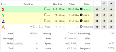

Hi everyone,
I've got a Buildbotics controller hooked up to my Taig mill and I'm using a toolsetter probe between tool changes to automate the process of measuring new tools for jobs with multiple tools. The probe sits at a fixed point in machine coordinates (I just bolted it to the table), so I am trying to either use G53 to move in machine coordinates or G92.2 to temporarily disable global offsets so that I can then move to the probe position in machine coordinates. For context, I do have homing switches setup on my mill. The problem I'm running into is that the Buildbotics controller does not respect G53 or G92.2, it's as if it's still trying to move in work offset coordinates. Because of this, when I have the work offset set closer to the upper limits of the axes, the controller will say that the job will move outside some axes bounds (even though it won't, since on the toolchange it will be moving in machine cooridinates), and thus I can't start the job. Has anyone else had this error and possibly know how to fix it? Thanks!

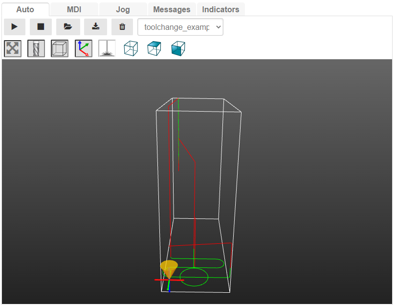

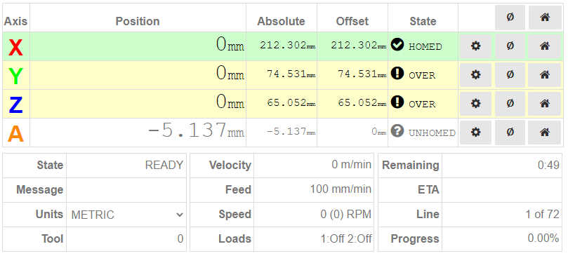

Hi Doug, Skyler, and XCross,
Thanks for your responses! Doug, my tool change script is attached below, along with a simple program utilizing a tool change. As you can see, in the Buildbotics web app, my G92 offsets in this example are set to X: 212.302mm, Y: 74.531mm, Z: 65.052mm. My probe is located in machine coordinates at X: 0mm, Y: 85.8mm, and I park the tool at Z: 85mm in machine coordinates for some clearance above the probe to change tools.
The example program I’ve provided simply faces off a 25mm x 25mm square block, changes tools, and then uses a different tool to trace out a 12.7mm diameter circle within the stock. For context, my axes limits are set to X: 270mm , Y: 135mm, Z: 150mm, so I should have plenty of Y and Z clearance for this small part. However, as you can see from the screenshot of the Buildbotics DRO, it says I’m going over my Y and Z limits due to the toolchange. And, in the visualization, you can see that instead of moving to X: 0mm, Y: 85.8mm in machine coordinates, it is moving to these coordinates with the G92 offsets applied. Thanks for your help and please let me know if you need any additional clarification.
In response to Skyler, thanks for providing your toolchange script! I will have to see if I can replicate this on my machine.
In response to XCross, I believe we’re having the same problem, which would lead me to believe that this is a software issue and not just you.

I reduced the program to this:
This took the tool change out of the picture and just executes the G53 commands. Sure enough, this cause the Y and Z lines in the axis table to turn yellow and display 'OVER'. However, when I actually run the program, it seems to complete correctly.
I also tried this same program in the new V1.0.0 software that we are about to release. The result was the same.
I also tried the G92.2 command as suggested like this:
I got the same result.
My assessment is that G53 and G92.2 offset changes are not handled correctly in the simulation, however they work correctly when executed either in the tool-change or in the main program.
If you agree with this assessment, I will submit a new issue in our github tracker. Hopefully, we can get if fixed in V1.0.1.
What do you think?
