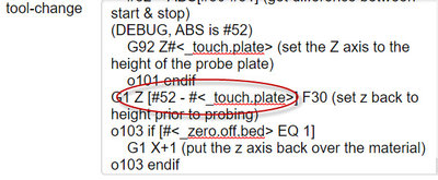

I'm running into an issue with my settings not being updated after a save every time. Here's an example. I made the change that is circled and saved. Then ran the gcode and I get the error in the second figure.
I tried saving several times with no improvement.  Then I restarted the controller and I was back to my original code (shown in red type & circled below). I then edited the settings again and saved... and the code was executed correctly.
Does this mean I need to reboot prior to making changes or is there a way to refresh things without a controller reboot.
