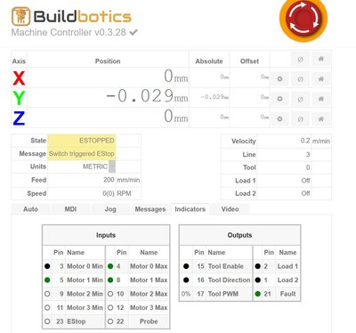

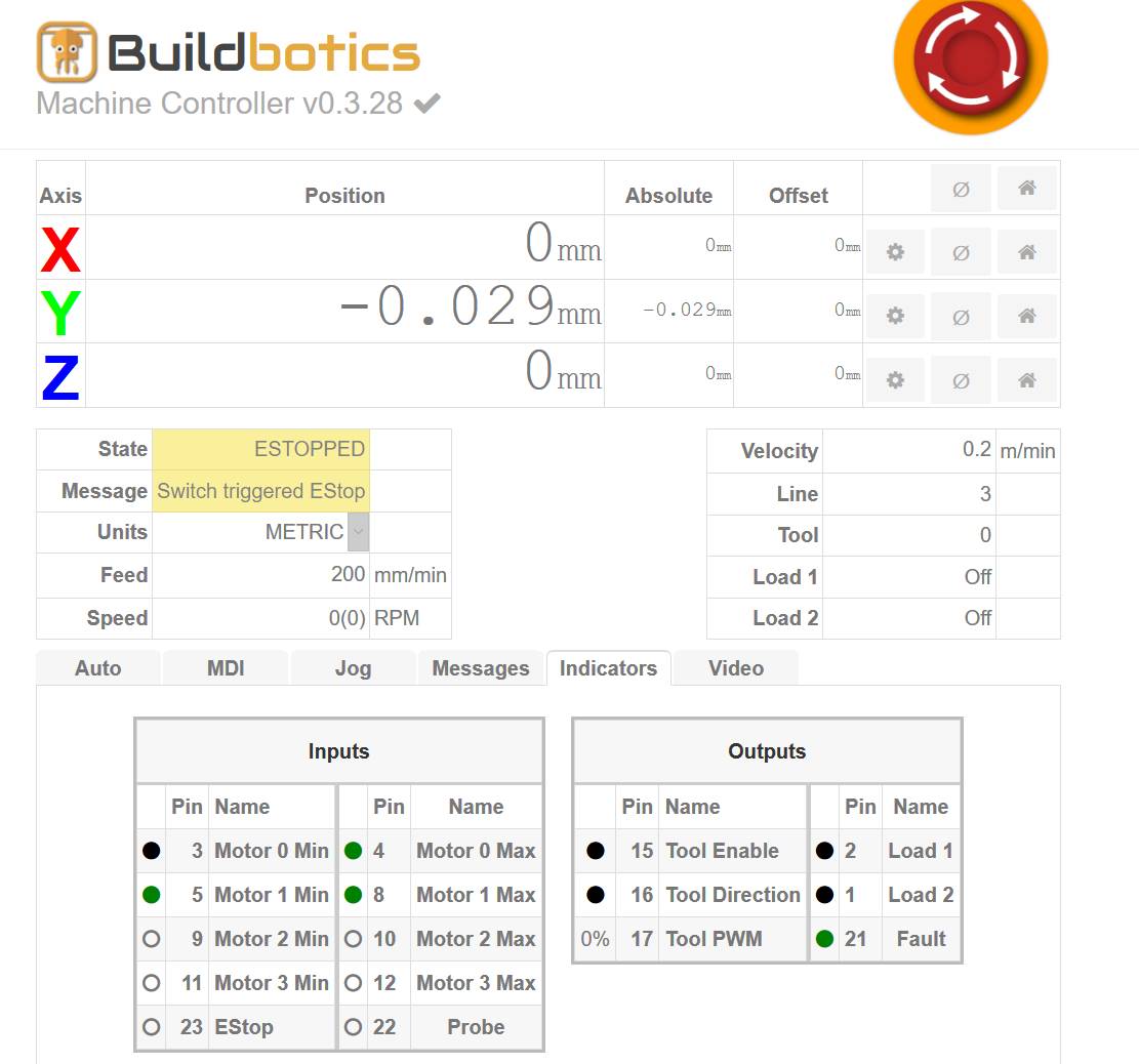

Quick question – I’m having problems homing my Buildbotics. I’ve install limit switches correctly and can see the status change in the indicators tab then the switches are activated. The problem I’m having is when I go to home the x and y axis as soon as the limit switch is triggered the Buildbotics detects this as an estop and does not follow the expected backoff, latch actions. I’ve only connect the motor limits switches to pins 3,4,5 and 8 (for M0 and M1 min & max switches) with power/ground going to pins 6 and 7 on the DB25 I/0, I’ve using Makerbot limit switches.
Can you please help me figure out what’s going wrong?

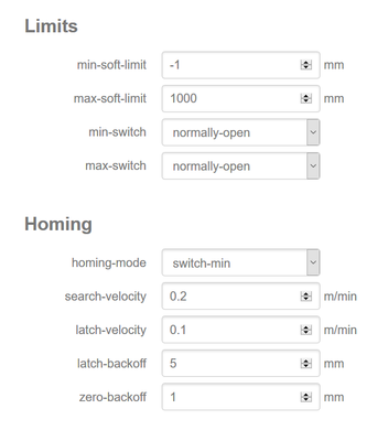

Thanks Doug - I've set both the X and y soft limits setting as followings but still getting the same issue that when the switch is triggered the Buildbotic controller triggers an estop rather than the homing sequence.

From your first post, it looks like the Motor 0 min switch is active. It is possible that the switch is still engaged. If you can see it, please verify that it has opened. Another way to test is to verify that you do not have ground on pin 3. If the switch is still active, try increasing the latch back off distance on the motor configuration page.

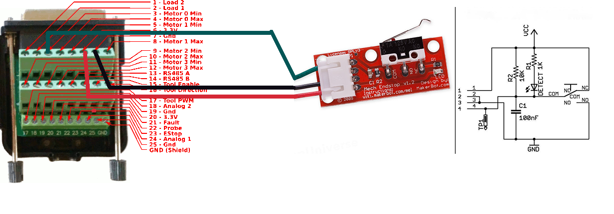

Will have a play in the morning (23:40 here in the UK). Below is the wiring diagram for the endstop I'm using in case you can see anything obivously wrong there.

Thanks for sending your configuration. I have it loaded on my machine. I had to make a few changes in the limit switch configuration to make it match my machine. I only have limit switches on one end of each axis.
I ended up with my x-axis limit switch being wired as a maximum limit but your configuration had it assigned as a minimum switch. When I attempted to home, it resulted in the exact failure that you have described. In other words, the machine goes into e-stop as soon as the switch is closed. More succinctly, while the machine was searching for xmin, xmax activates causing estop.
I suspect confusion may have occurred because, in the past we assumed that people would connect motor 0 to the X axis and motor 1 to the Y axis. So, we used to call pin 3 x-min, pin 4 x-max, pin 5 y-min, and pin 8 y-max. Of coarse, this was silly because users are free to assign their axis to any of the motor outputs. I noticed that you assigned your X axis to motor 1 and Y to motors 0 and 3. In the new version, you will notice that we named those pins motor 0 min, motor 0 max, motor 1 min, motor 1 max...)
So, I have to ask you to double-check your limit switch wiring. make sure they are wired as follows:
* Motor 0 min goes to pin 3 (your y axis minimum switch)
* Motor 0 max goes to pin 4 (your y axis maximum switch)
* Motor 1 min goes to pin 5 (your x axis minimum switch)
* Motor 1 min goes to pin 8 (your x axis maximum switch)
I apologize for the confusion and hope this gets it fixed. Please let me know how it goes.
