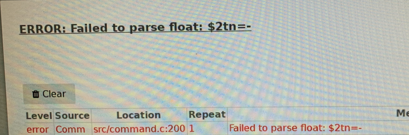

So at first I couldn't get this to reproduce since I'd updated it via my laptop. Then today I was troubleshooting (my foolishness :P) a Z height issue. I went to adjust the min for Z again (which worked last night from the controller after I adjusted it via laptop) and the error came back. I snapped a photo with my phone (attached). And just as before I was able to adjust it remotely via my laptop with no issue. While this is only an inconvenience for me now that I can work around it, but it may be a bigger issue for those without connectivity. I would also note that I previously tried to work around this by exporting my config, modifying it with the negative and then reset and upload to controller, and this also was met with the same problem.
This happened when adjusting the Z min to -300 (though I've tried all sorts of numbers. It only happens (so far) from controller (with keyboard OR mouse input - tried to rule out an input device issue) and only for negative numbers.

I know this is an old post, but I’m experiencing the same issue. What’s happening is when you try to set a negative minimum soft limit on an axis from the controller itself you’ll get the error message about parsing the float. If you do the same thing connected remotely, the issue doesn’t occur. Also - when you get the error connected to the local console your machine gets stuck in jog mode so you can’t home any axis (or do anything to it really) without rebooting.
Hope this helps! I’m on the current firmware so it’s still an issue.

I went and tried this out again from my local head and found that I do not get the error when using the soft keyboard with my ASUS VT168H touch screen monitor.
However, I do get the failure when using a hardware keyboard on the local machine.
I have updated the github issue on this subject to reflect this new information. See https://github.com/buildbotics/bbctrl-f ... issues/249
Re: Unable to set soft limit to a negative number.
Post by Doug » Thu Mar 04, 2021 8:20 pm
This will be fixed in Version 1.0.
In the mean time, if you are using a hardware keyboard with your local head, you could uninstall the virtual keyboard. You can do this by opening a new tab on your local interface and navigating to https://chrome.google.com/webstore/deta ... ninn?hl=en . Then, follow the instructions to uninstall the soft keyboard.
