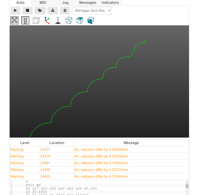

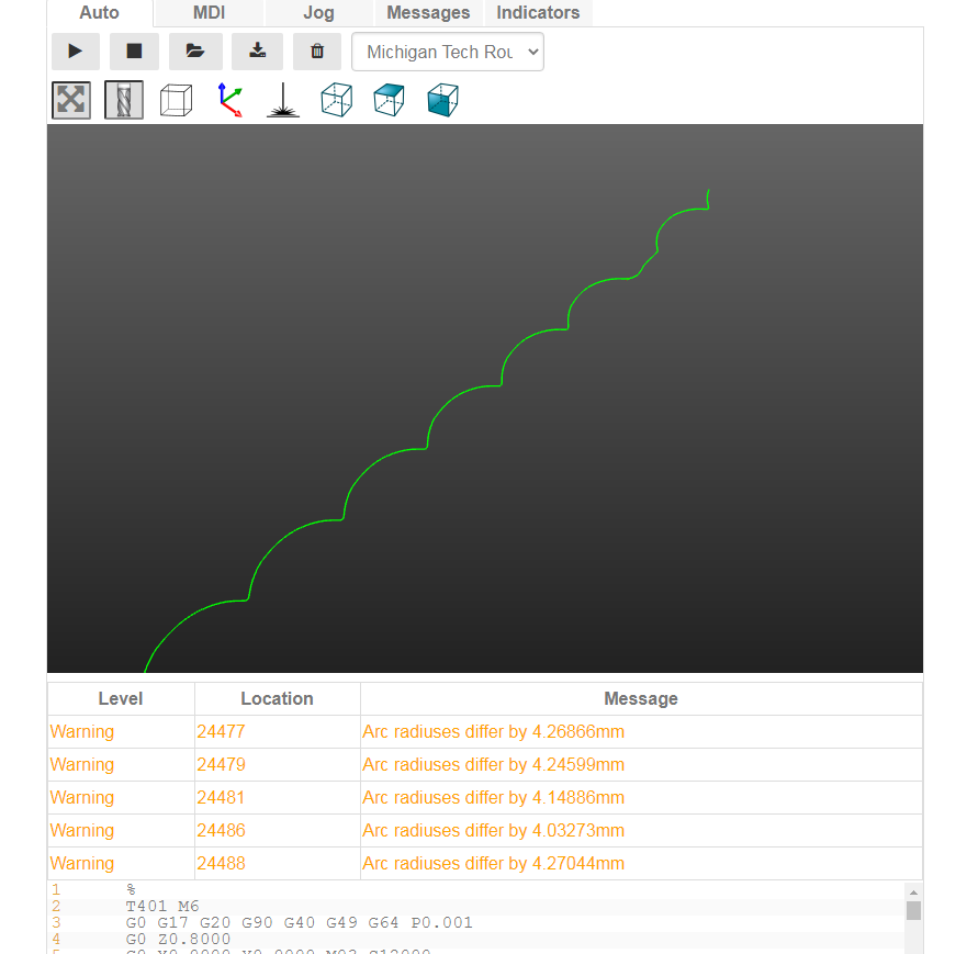

Just getting my machine up and fully running. I made a pretty simple carving sign. When I save all of the toolpaths individually from Aspire v9.514, they all load fine, render fine, and cut fine. But when I save them all into one file, I get errors about arcs are off by 4.xx mm, and the file renders as a squiggly line, and that's it. It doesn't print most of the way through, though. But then throws an error I can't seem to recover from - I had to reboot the controller. I then loaded the individual file where it gave me the error, and it continued on OK and I finished up the last files one-at-a-time.
In the file is the all-toolpaths file, and each individual path. They are saved in this order:
Huskies Outline
Text
Huskies
Inner Circle (it errors when starting this one in the all-toolpaths file)
Outer Profile
Huskies Outline (Clear)
Cutout
I also attached a screenshot showing what the rendering looks like (just a single squiggly line), and the errors it gives.

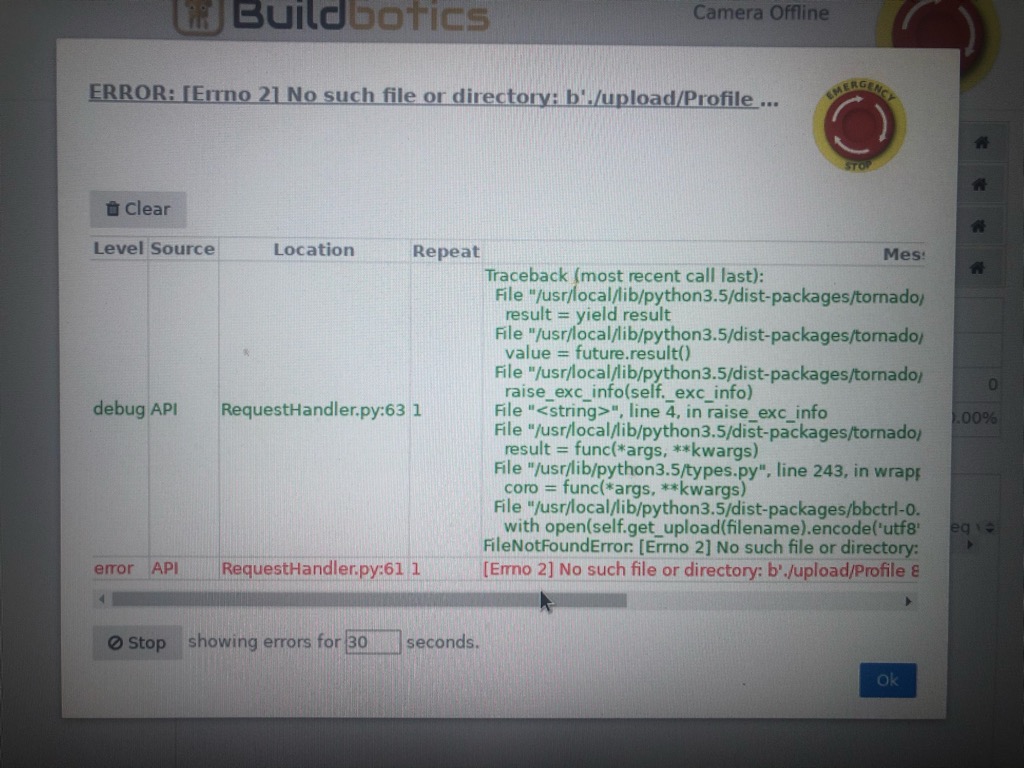

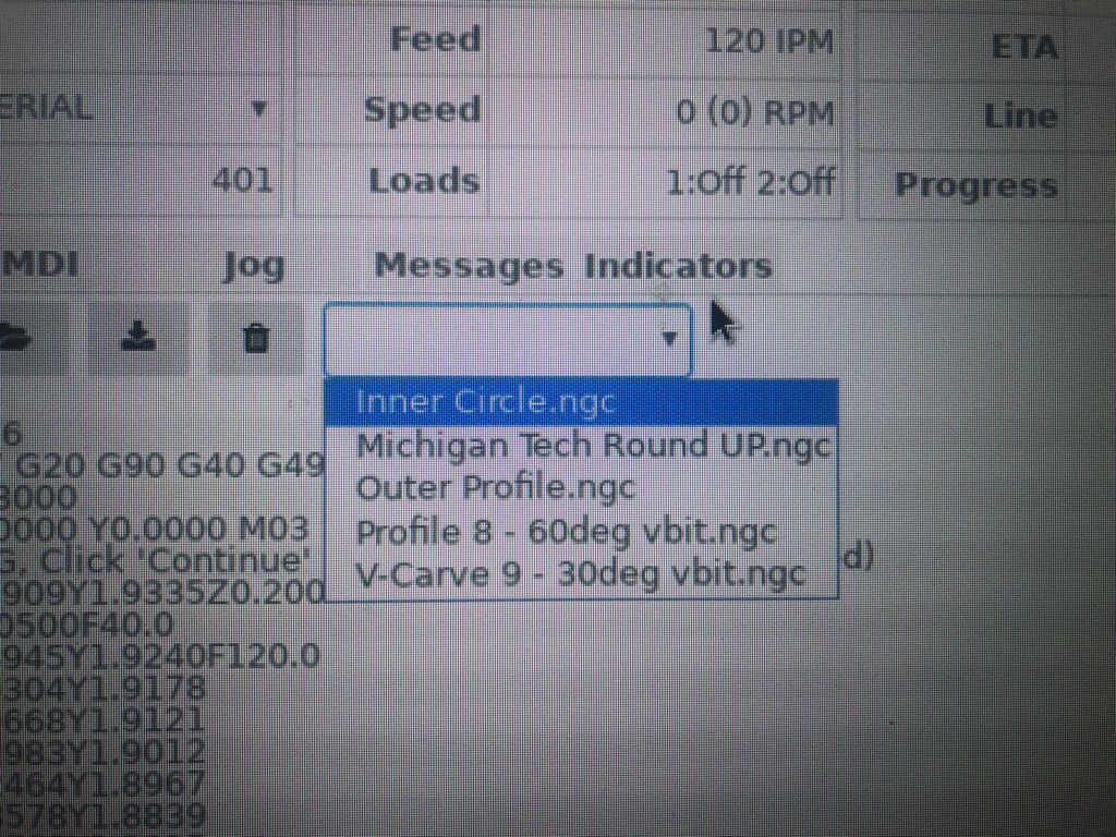

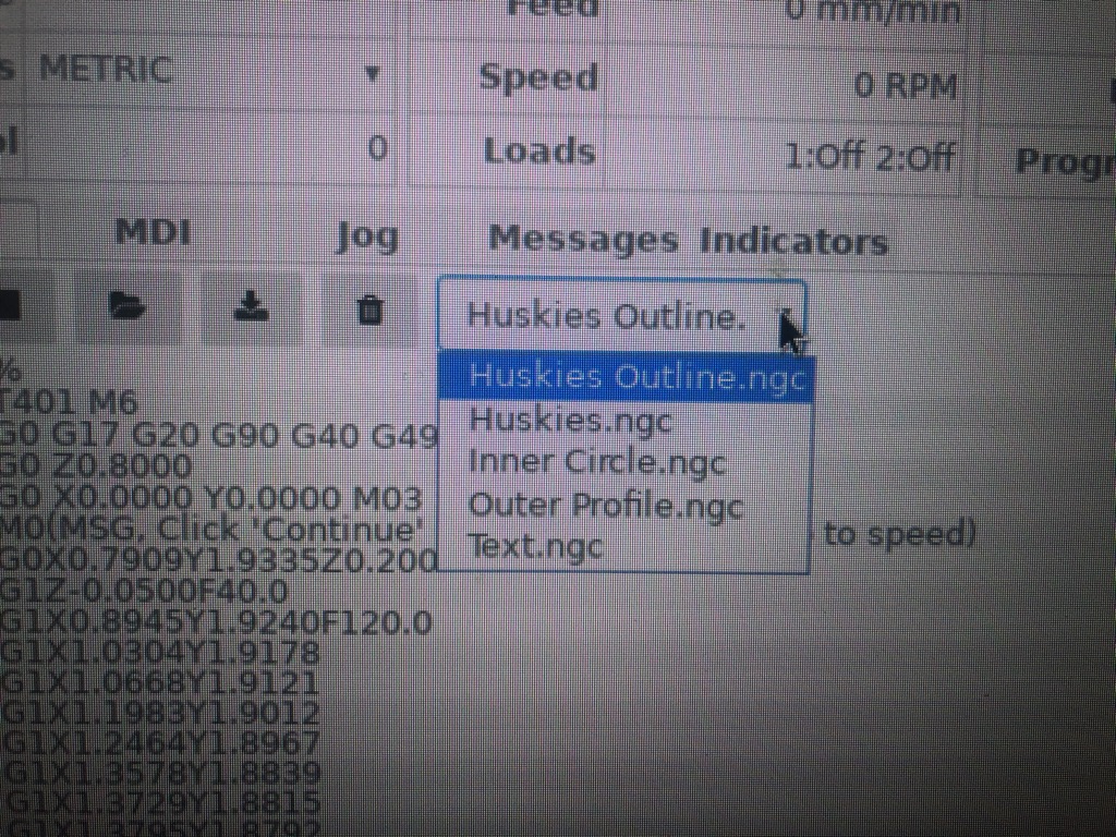

Had another issue last night, also. I was running one of the programs and then stopped using the stop button when when my piece moved. At that point, I was unable to jog it because it kept saying a job was already running. Hitting stop didn’t do anything. The list of programs shown on the controller was incorrect and I had to reset the controller. After that, the list of programs returned to the correct list and I was able to jog again.
Attached are pictures of the program list before and after cycling the power. There’s also one where showing that it couldn’t load the selected program from the list.

OK,
I loaded your configuration and then reloaded 'Michigan Tech Round Up (all toolpaths).ngc and now I get the errors with a squiggly line displayed. I'll dig further and let you know what I learn.
Re: Multiple toolpaths in one file - errors and won't render
The problem is that your tool change procedure on the 'Settings' page changes the units to 'Metric' using a G21 command. Your program runs in 'Imperial' units using the G20 commands but the tool change procedure changes it mid-stream.
Since you want your configuration for tool changes to work with either metric or imperial units, you should push the machine state at the beginning of your tool change procedure and then pop the state at the end of the procedure.
You can do this by inserting n 'M70' at the beginning of the tool change procedure on the 'Settings' page and inserting an 'M72' at the end.
You can see this in my posting on the subject of probing at viewtopic.php?f=6&t=117 .
