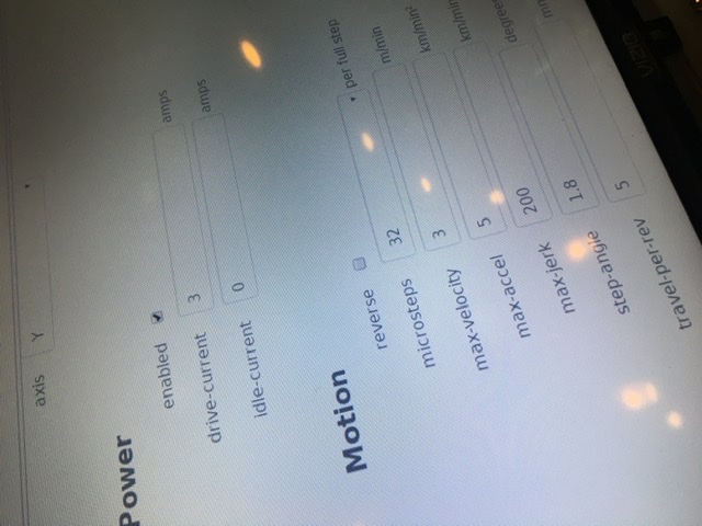

Post by ramurph1 » Sat Apr 10, 2021 10:47 am
I haven’t done any cuts yet, although I do have the VFD configured and working properly. All home switches and hard limits are working on each end. The controller is very versatile and accommodating. I understand that test cuts may go a long way in getting things tuned. I’m just waiting on some T track to get the waste board installed.
I’ve attached a few pics of motor config. Thanks for the help!
