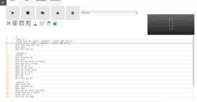

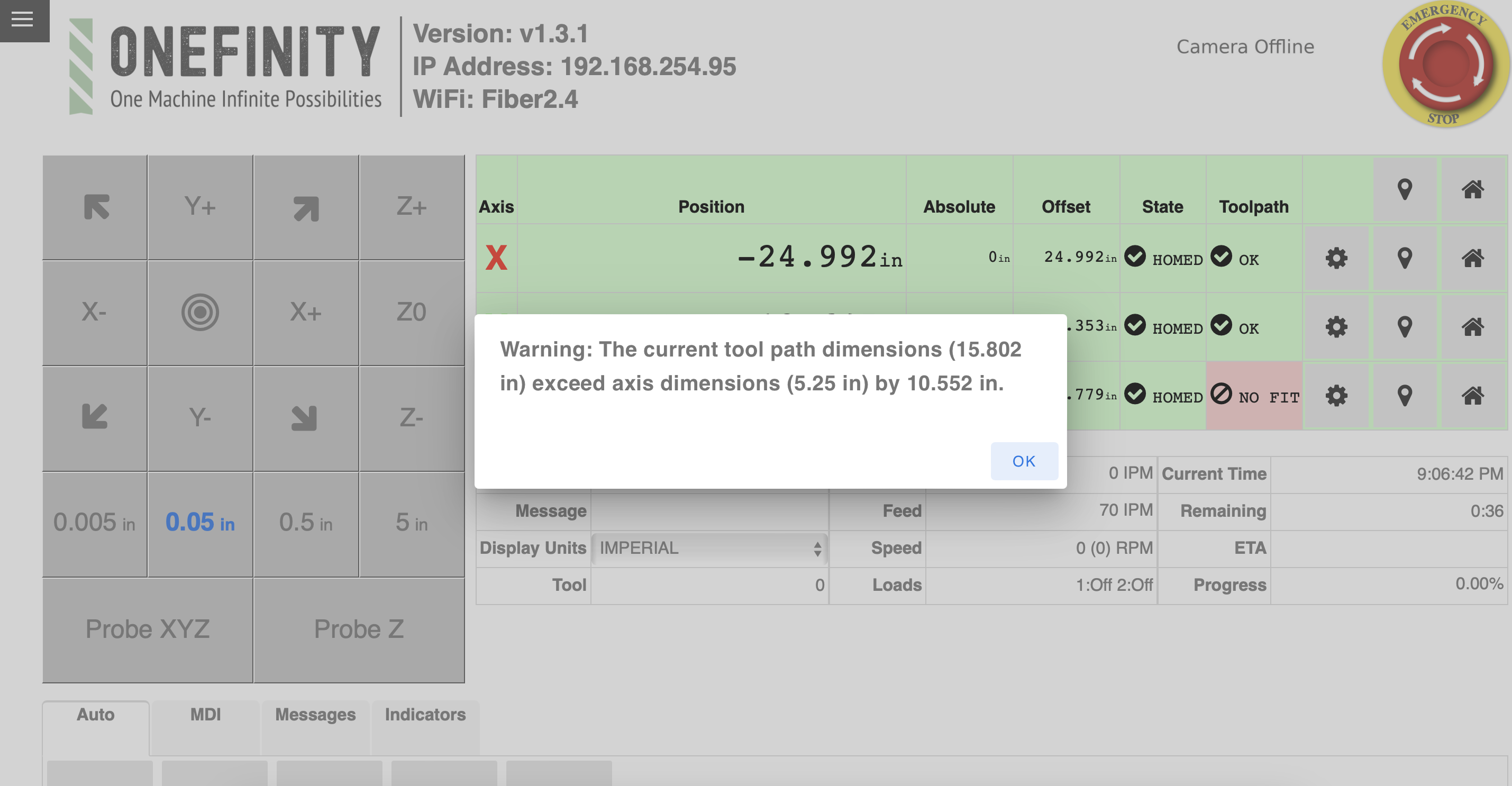

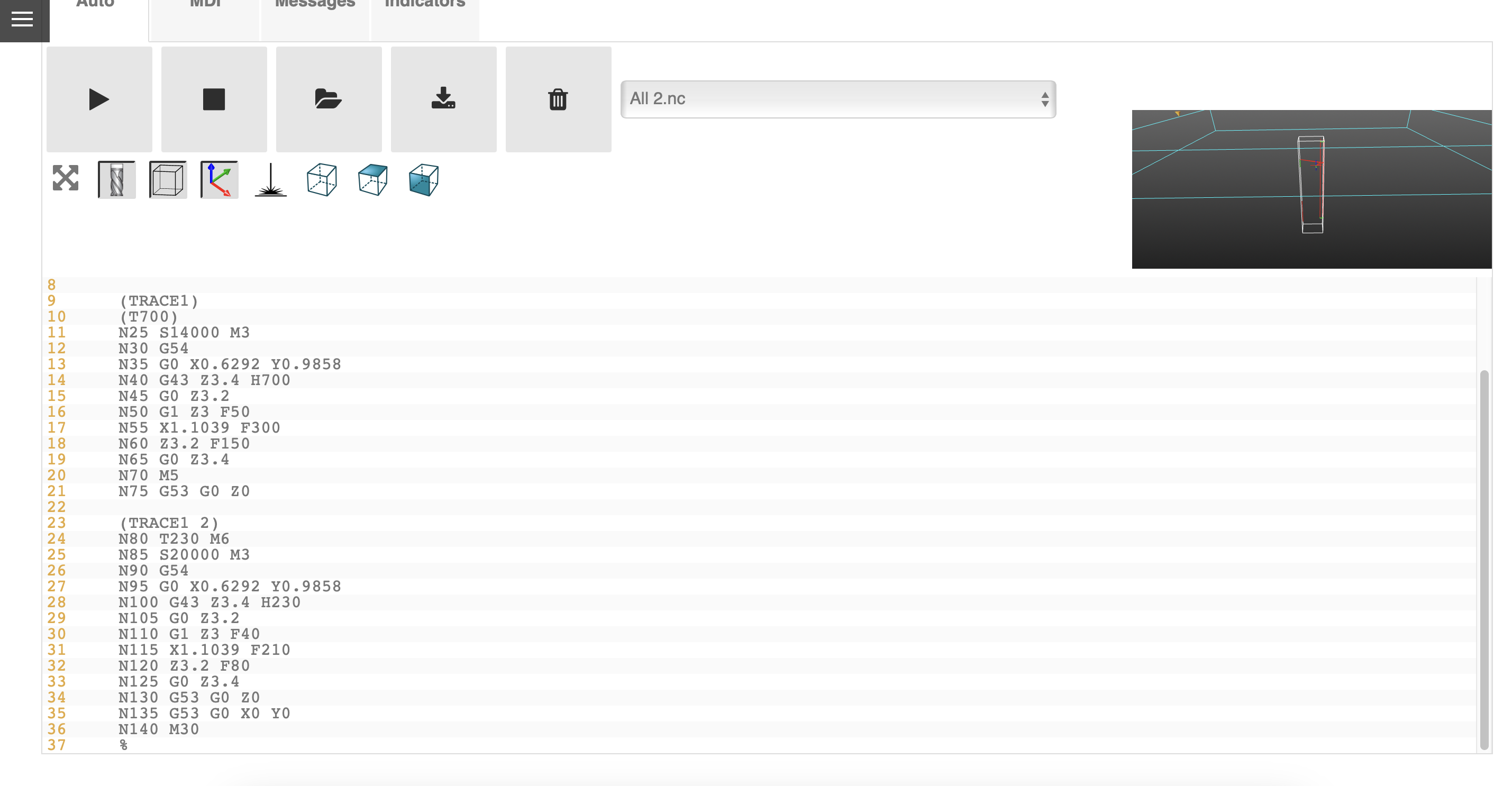

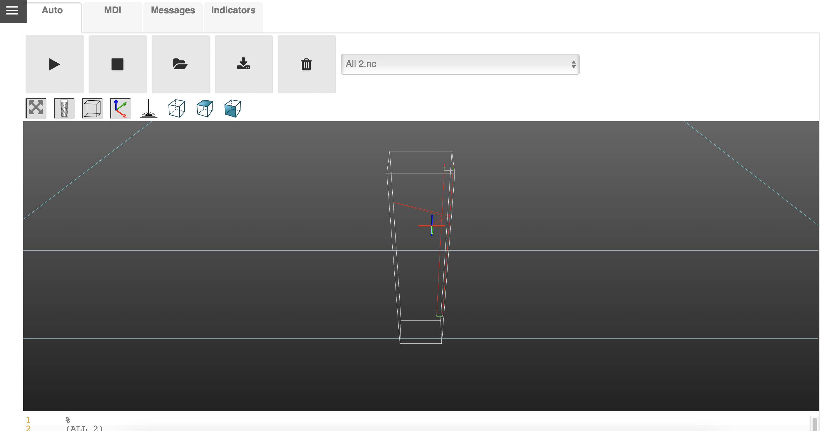

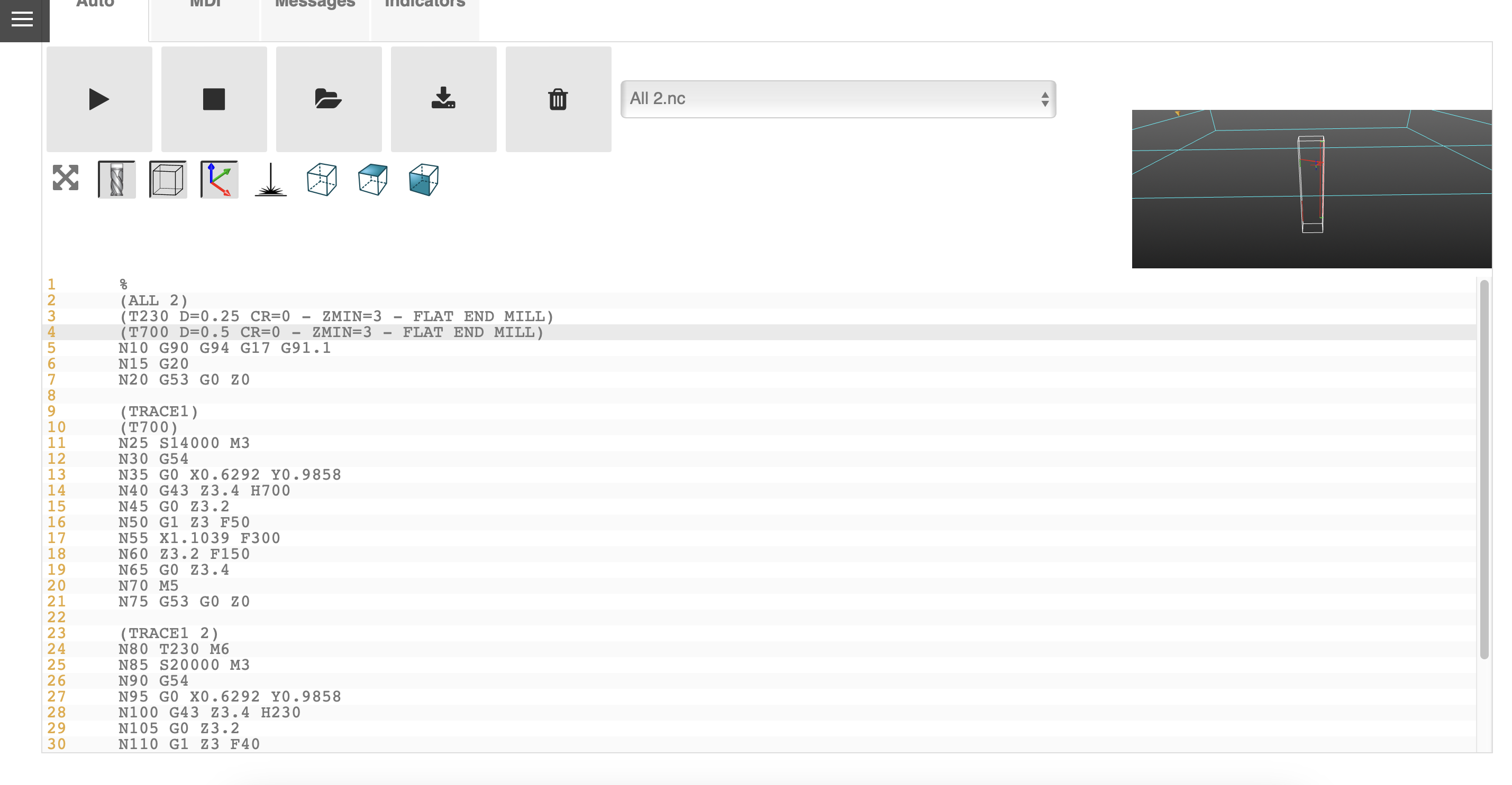

When I post a file with any tool changes, in the preview pane I see the first tool path posts correctly and the XYZ is shown in the preview. The following tool paths are below the XYZ by about 15" and I get an over limit when I load the file. Pictures attached. The Code does not show the Z trying to go that low, it looks normal. I use Fusion and the simulation matches the NC. If I post the NC based on each tool, even if there are multiple operations with the same tool, everything works as normal. I am also attaching the actual NC along with pictures of the GCode thats on the screen.

This is a problem that existed in the Buildbotics Controller some time ago. It was fixed quite some time ago.
Onefinity copied our software and hardware back in 2021 and went their own way. Apparently, they never fixed this problem.
