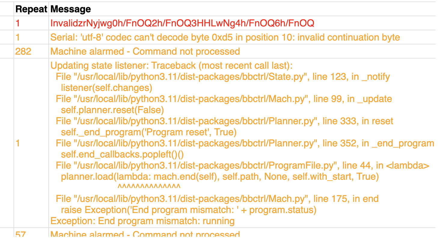

Hello team,
the other day I faced a more or less critical error in the middle of a program which stopped and seemingly reset the machine (and homing). Unfortunately the error message is quite cryptic and I have no idea what could have caused this
ERROR: InvalidzrNyjwg0h/FnOQ2h/FnOQ3HHLwNg4h/FnOQ6h/FnOQ
After hard restarting the controller, the program ran through fine. Out of 5 20min runs I encountered this error twice. As far as I remember its the first time I am seeing this error, so I wonder if its connected to the latest firmware update (2.0.4). Maybe someone here faced the same error before and can point me into a direction
the related log section looks like this:

I:Planner:Cmd:{"type": "line", "id": 1742, "target": {"x": 1363.49, "z": -81.93}, "entry-vel": 154.6, "exit-vel": 154.6, "max-vel": 2828.43, "max-accel": 989949493.66, "max-jerk": 1414213562.37, "rapid": true, "times": [13.27, 0.0, 13.27, 0.43, 13.27, 0.0, 13.27]}
I:Comm:< #id=1742\nlO5kaQwuQVsTgX5aoTgxw2+qRAzrNyjwg0h/FnOQ2h/FnOQ3HHLwNg4h/FnOQ6h/FnOQ
I:Comm:> {"firmware":"Buildbotics AVR"}
I:Comm:AVR firmware rebooted
I:Planner:20250709-193708:Program reset
I:Comm:I2C: S b=None w=None d=None
I:AVR:I2C: S b=None w=None d=None
I:Comm:< c
I:Comm:< h
[color=#FF8000]W:AVR:Serial: 'utf-8' codec can't decode byte 0xd5 in position 10: invalid continuation byte
I:Comm:> {"level":"error","msg":"InvalidzrNyjwg0h/FnOQ2h/FnOQ3HHLwNg4h/FnOQ6h/FnOQ","code":8,"where":"src/command.c:200"}
E:Comm:InvalidzrNyjwg0h/FnOQ2h/FnOQ3HHLwNg4h/FnOQ6h/FnOQ[/color]
I:Planner:20250709-193715:Program reset
Attached are the full log and a screenshot of the error

In looking at your log, it appears that the error occurred right after the avr rebooted.One of the things that 2.0.4 changed was to prevent the controller from getting damaged if the usb bus is overloaded during bootup. We found that if the usb bus is overloaded during bootup, it causes the attiny to reboot. I am wondering if such an overload could also cause the AVR to reboot. Please list any usb devices that you have attached. Also, do you have any other loads on the 5V supply such as relays or active limit switches or an active touch plate?

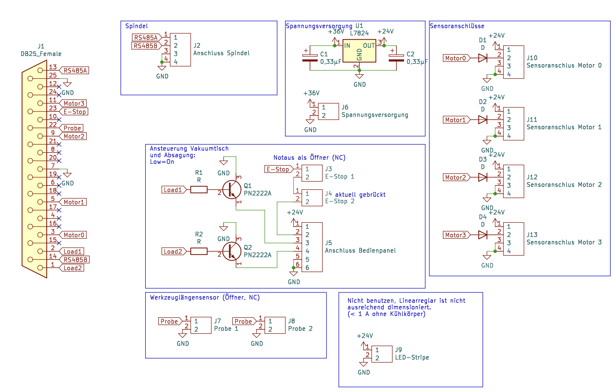

We do use a couple sensors and relays via a custom breakout board thats connected to the 25-pin connector, but I am not certain if and how they are supplied by 5V, thats not my expertise.
List of whats connected:
- fixed tool length sensor (Sorotec WLS2)
- inductive limit switches for all axis (10...30 V 2 mm NPN NC)
- external relays for vacuum table and dust collection (Load 1 and 2)
- 2 e-stops in series
I attached the diagram for our custom breakoutboard, unfortunately its in german

I don't see anything any problems in your schematic.
