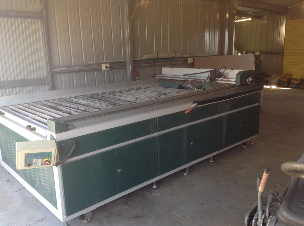

Well, I found someone to move that Chinese 1325 laser cutter from Sydney at a reasonable price, so this is going to be my test bed. It didn't come with the original PCI/DSP controller, which is fine. Already found a NOS tube for it at half price too, thus solving the reason it wasn't working in the first place.
