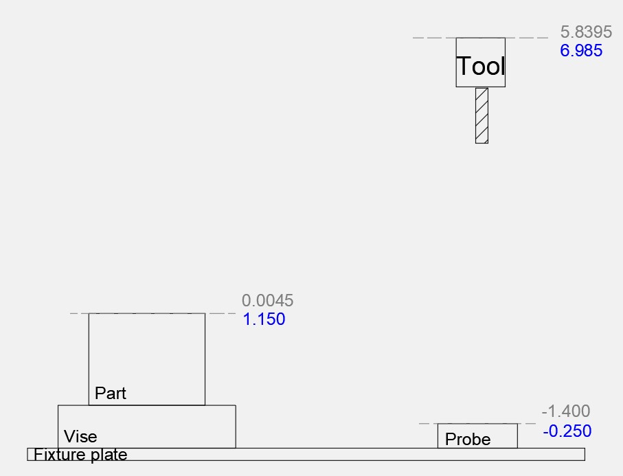

Yes, you are correct with that sequence. The #<_z> parameter reported is +1.4 (instead of -1.4).
The only issue with your last post is that the machine is not moving to Z8.385 - I'm doing this move as a G53, so regardless of the fact that I set my WCS on top of the part it is always going to move to 6.985" in the machine's absolute coordinates. It's not moving to 6.985" in G54 (which would be 8" in absolute but 6.985 in relative coordinates), but moving to 6.985" with respect to how the machine axes and soft limits are set up. Regardless of work offset / current position this takes the machine to the very top of my Z column, right before the limit switch. So when I do the G38.2 Z-6.985, I'm essentially just telling it to traverse the entire Z axis until it touches as my Z- soft limit is at zero.
I made a quick graphic that explains the relative G54 positions (in grey) and the machine's absolute coordinates (in blue). Since #<_z> should report the current relative offset it should be giving -1.4 but again was positive. I did also while I was playing with it move the machine to the actual +1.4 position and confirmed that the parameter returned the same value in both positions.
