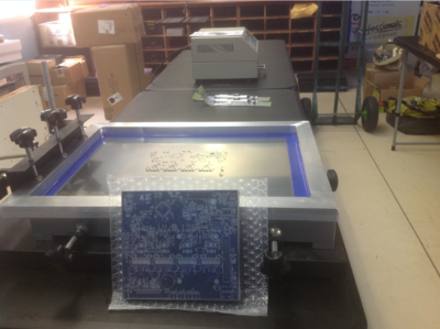

My PCBs and solder stencil arrived today. Still waiting for a heap of parts though so won't be picking and placing just yet. The component shortage is proving to be a bit of a bear, and some substitutions had to be made.
I had originally intended to use this board on a laser cutting machine of my own design, but a used Chinese 1325 laser bed of 2010 vintage has shown up and if I can find someone willing to move it from Sydney 500km (310 miles) away to my place this board will make an ideal replacement for its old controller.

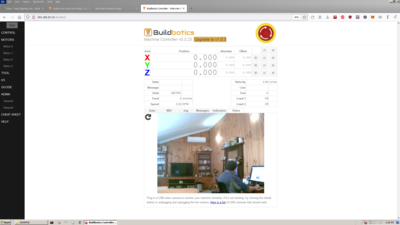

And here's a happy snap of the BBCTRL software running remotely on my PC, complete with webcam output. I used the same camera as BuildBotics sell on their website, 1080p resolution. Nice camera!

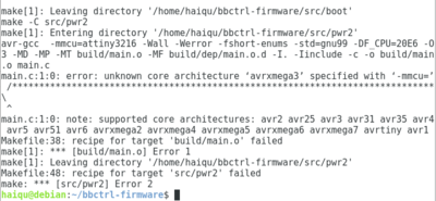

By fishing around in the code I managed to find both the device-specs file and libraries for the ATTiny3216, which is handy. Figuring out where to install them was a little of a challenge but that went fine eventually.

By about 4:30am it had become clear that the main issue was the dinosaur version of OS specified in the docs. Debian 9.6.0 contains gcc-avr version 4.9.2 which just doesn't cope with avrxmega3 chips at all. Never did, never will.
So, I expunged that garbage and installed Debian 11.3 - which has access to gcc-avr 10.2 - and once that was installed the build went swimmingly. Well, except for the other problems, but that's a job for tomorrow, I need my beauty sleep. :-)
