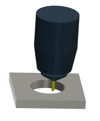

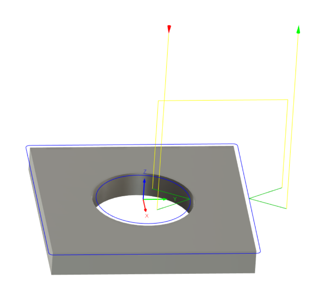

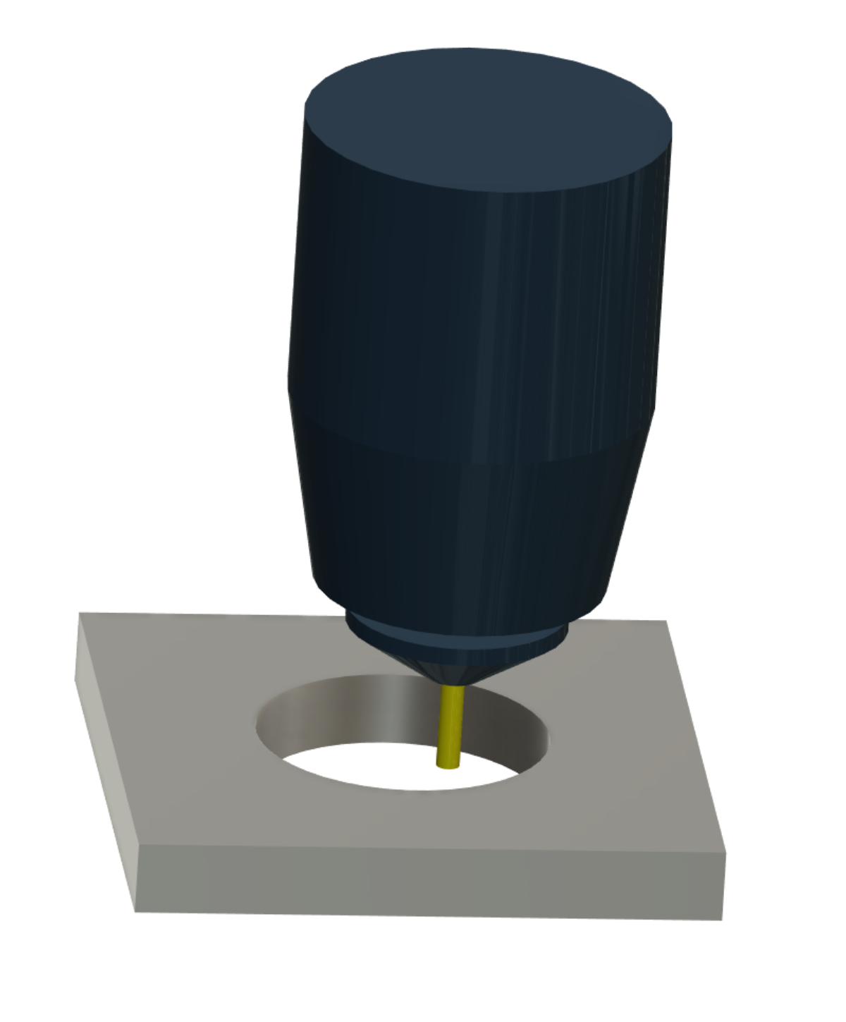

Seems to be some bugs still. I am not getting my between cut retract moves that are being simulated within Fusion to come out in the Gcode, and the tool is turning on at the wrong time.
If you look at this tool path, the machine should move to the start position inside the inner circle, Z down to the plate, turn on the tool, cut the circle, turn off the tool, retract 1 inch, move to the outer square, repeat.
When you simulate it inside of Fusion you see that exact behavior. It shows the 'cutting' stream of the waterjet/laser/plasma turning on and off as required.
However when you post process this, the output is much different:

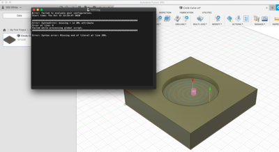

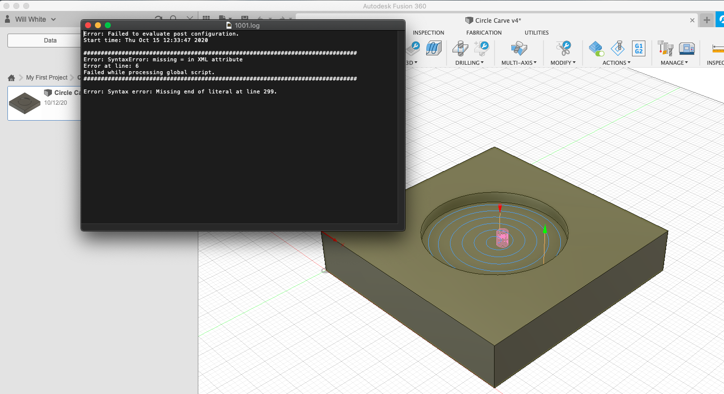

I have uploaded the BuildBotics CPS twice into Fusiion360 and receive the same Syntax Error. Any advice on how to fix this would be great.

Just uploaded the newer version of the post processor and still receiving the Syntax Error.
