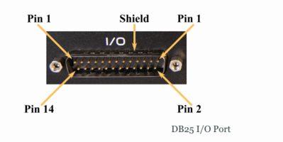

I am confused by the I/O port diagram in the manual. It is indicating 2 pins to be Pin 1. Is there an image with the complete Pin assignment? FRom what I know a standard Db25 I/O port looks more like the 2nd image where the upper right pin is 13 and not 1 and lower right pin is 25 not 2.

Sorry,
It looks like the right side of the image got cut off in our manual. From left to right, the top row of pins is 1 - 13 and the bottom row is pins 14 - 25.
Thanks for pointing this out. We will correct the manual.

The manual has been corrected.
