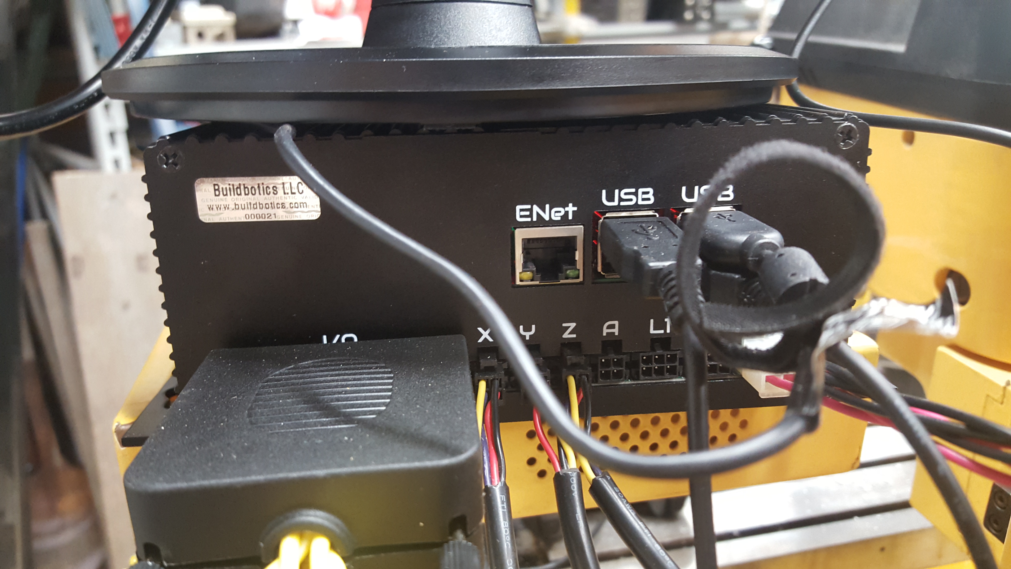

So I FINALLY got around to dusting off the DM2400, gutting the electronics & getting the BB controller wired in.
I'd purchased an ASUS VT168H touchscreen monitor, only to discover there is no "monitor" port on the back of my BB controller (serial # 000021) YIKES!
I REALLY like the one idea of a touchscreen monitor at the machine - would the HDMI be accessible inside the controller? Or...?
Thx

Back of my controller.
Guess I was too early to the party?
Back of my BB controller

Yes, we weren't bringing out the monitor port to the back of the controller for the first few months. The port is available on the Raspberry PI and if you managed to get a hole through the back of the controller, you could plug directly into the RPI.
I haven't heard much from you. How is your system working out?

Yeah, I went ahead and open it up & got monitor connected inside. Only spent a few minutes on it, but when I turned everything on, I only saw the boot up sequence (lots of text scrolling) rather than the BB logo. It ended with a login prompt. Do I need to set something to get the interface to present on the monitor?
Making slow progress - but at least I am now back in the shop somewhat. BB controller had remained in its original shipping box until just a week ago! Yeah, 2-1/2 years, just to unbox it!!
Mark

You probably need to upgrade the software.

Hmm... It's running v0.4.14 - with a checkmark next to it on the web interface: this indicates "latest version" -- correct? Or were you referring to something else?
